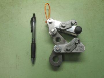

I'd go with the adjustable version. The whole upper assembly is just awesome. Totally solid, being machined out of a single billet. I would also request that Gordon installs an Allen Screw for the adjuster. You will be able to dial this unit in for quite a wide variety of rope options with precision.
I can provide any type of 10-32 machine screw desired or requested. I have a good supply of SS oval head machine screws stock, with a combination philips/slotted type head.
I just have to shorten the thread length to just reach the interior friction pin, and re-dress the threads. The nut that holds it captive is a special order low profile friction jam nut.
Here are a couple pics of the adjustable Bulldog Bone, as I have been asked for a picture.
I really do love the new top assembly. With the older version, I really focused on pulling evenly on both sides to actuate descent. Since the new adjustable piece is solid billet, it has a bit more of a solid feel that's hard to put into words other than "refined". Great work there, Gordon.

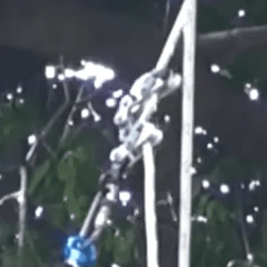

What's this a bone mod? Check around the 1:18 mark
This is a fun video to watch alone, but several times you see a very good shot of something that looks like the Bone with serious mod.
It looked like a handled solid body device, like the Grigri to me. The handle, if that's what it is, sure sticks up away from the device.
There is another video which shows better what he has changed. It looks to me like he has removed the D-ring and the aluminum spacer between the top arm pivot, and replaced the spacer with a relatively large carabiner as his tending point for ascending.
From the pictures you posted, it looks like the standard "hook" lower arms to me. On some of the first Bones, I did have a 3/4" roller which could be inserted after the rope was installed, using a quick pin as the axle, but it was deemed un-necessary and too fiddely by users, and I would have to agree.
