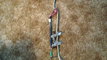

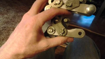

So just out of curiosity has anyone tried putting the spine hump towards the rope side. I have one of mine that way to try but it rained today so maybe I'll get a chance tomorrow. It looks like it would be perfect to apply just a tad bit of pinch and added friction.
I think someone posted that quite s few pages ago but not sure. In theory, it might be like one of those "baby bump" Rope Runners. I'll have to give it a shot to see what it does, but there may be little point since my Bone is currently working so well. I guess if the top arm release was easier and more modulated it could be a good thing.
My exact thoughts Eric. My RR had many variations of baby bumps and it did help me. The BDB works well also, I am just looking to dial it in to my own personal perfection.
Ok so that does nothing, the bump moves out of the way on descent completely does not do what I was attempting. Maybe a well placed baby bump will but that is for a latter tweak.
Okay as crazy as that looks above it may be worthy of more thought. I just put weight on it and tended it a few times. It tended as it should and was silky smooth. I think it needs some more testing and probable tweaks but this may work.
