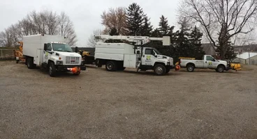

So the weather is starting to turn here in Nebraska (9 degrees this morning) and each year the cold causes me problems with my equipment. I do not have indoor storage and I do not have electricity at my lot. Any productive, helpful advice would be sincerely appreciated. My problems are as follows:
Vermeer s600tx: I have the 25 horse diesel kubota motor. The thing is so cold blooded i need to jump it every cold day in order to get it to start. I have heard this is a notorious problem for the motor. I wish I could put a yanmar in it.
Vermeer sc372: My throttle cable freezes up. It acts almost like a ptrap and collects water in the low point. It is stored outside so this problem seems inherent. I talked to the vermeer engineers at tcia but they had no advice. Right now we have to bend the cable around to get the ice broke up and then it moves.
GMC 7500 bucket truck: The pto has a similar problem as the stump grinder. It gets water in the pto line and freezes.
Unfortunately a building for a shop is not in the near future so I need to work out these kinks with my situation as is. Thanks tree buzzers.
