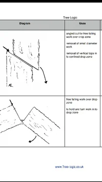

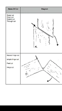

Those two tops were prime for a salami cut. Slide those fellas straight off the bar. Nice fast cutting saw and be done. You would not even notice any movement. Slide them straight in the hole. Use that slight lean and gravity to your advantage. Notching is used on mainly vertical wood. On leaning limbs a snap cut is also good. Allows limb to land flat. A proper hinge can be used to turn those leaners though away from a target.
That top would have come down one me if I would have cut through it without notching it. Yes tree trunk had significant lean was lean, but that top was vertical, trunk leaned hard, too turned and shoot Straight up, so I definitely disagree with you on that one. Snaps cut it was also not an option, if the branch was parallel maybe, I still wouldn’t have done it, when you snap cut it tends to jump of the cut creating even bigger shockload.
Looked back. It was pretty vertical. I was going on memory from earlier. Notches were in order. Just keep them clean and back cut level. A little more lean over drop zone and salami that fella. A good snap cut creates little to no shockload.
Nah looked at it repeatedly. I would salami that into the hole. It was a small top and a enough lean. I was not there though and I am just going by the vid with one angle.
To avoid this on a salami cut, cut most of the way through and then pause to allow it to hinge slightly/your cut to open up. This will get the wood above you to move away from above your head, you only need to let it open a few degrees. Then power through the cut, just make sure it's a strong saw with a sharp chain.
Can also double kerf on the fall side to give it room to lean, or even a narrow notch for more lean.
Can also install dead twigs as sliders, or fit sideways as rollers so kerf edges don’t grip. Especially if use lean prior to finish spear cut.
I see so many using a notch in tree on leaning pieces and small branches that gravity already has a place for them to go. Fine if you are messing around with a football field drop zone.
