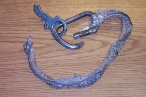

Tim, we have a policy that says "all winch lines shall be stowed and secured before any chipping operations begin". All chipper winch lines have to be completely rolled up on the spool, the hook secured and the diverter selector in the chipping position before any chipping starts.
We came to this policy after sucking in several winch lines, which causes major damage, not to mention flying shrapnel.
you should try black widow instead of the steel cable. We have it on most of our chippers now and it's pretty nice, no more cut hands on frayed cable. One problem though if your winching from odd angles the line gets sucked under the fairlead and it breaks, but you can tie it back together with a double fishermans.
