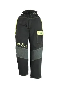

To all who have not yet seen ,
The Sip 5-1 are a five layer weave of chainsaw proof material as opposed to the usual nine,hence the name which gives about 200gr weight reduction.They were tested at SATRA laboratories in the UK and meet EN 381-5 class 1 (20m p/sec).They are stretch and have Kevlar knees.
I think there pretty good trousers.Picking can be a little bit of a problem and hanging top handled saws can melt them pretty quick with the exhaust,Although more pricey I still favour the Stretch Air.they last longer look cooler....
