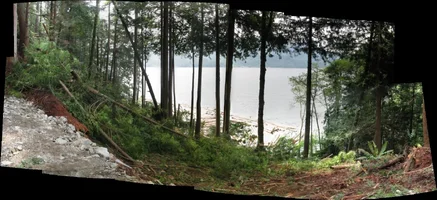

I'm not sure how many times one of us laughed and said "Wow! Now we're logging!" after we started using this setup. We initally looked at this job and were stumped as how to get all the brush up. This worked really well. Here's the view we cleared out. There was no view whatsoever when we started.
