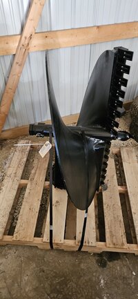

And here is the auger I haven't used yet:
As an aside...when searching for tree auger bit this is what is frequently advertised...in fact, when i ordered mine and spoke with sales rep explaining what i wanted, they asked "do you want a tapered bit - that's what we sell as a tree auger?"
I said "No, thanks. Every reputable publication for the last 30+ years says the hole should have a flat bottom.
With these things, there is NO chance the tree isn't too deep!
