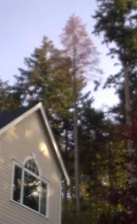

Here's a long shot view from below. Think this tree could have been saved?
The tree was way up on a hill behind the house. 30 steps zig-zagged up to the terrace. Newly planted Aspen and Cherry in the bed just below the tree would've been mowed down like a lawn if one of these logs had gotten away from us.
