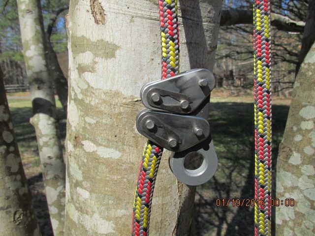

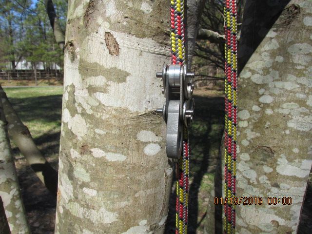

Here are a few pictures of this latest wider BOLA, which works on a wider array of ropes in the 7/16"-1/2" range. When heavily weighted it will release nicely by pulling down the bottom arm only and allowing the upper arm to friction brake. The outboard friction pins have bollards, while the inboard pins do not.
I have been using Gordon's wider BOLA version for several weeks now. I have tried it with Cougar (runs great), but It has been running fantastic with a used piece of Yale 11.7. Even works pretty good on the cable like HTP line. I'm curious to see how it will run with Imori and tachyon in the near future, but right now I am keeping the Yale 11.7 on my hip.
I have been skeptical about any mechanical adjuster taking the place of a classic hitch, but this new Bola has me thinking differently at the moment. It is ultra smooth. Not too friction free like the ART positioner, which would tend to gobble my slack while climbing, yet tending is consistently smooth.
As Gordon mentioned earlier, when fully weighted, it is easily adjusted by pulling down on the lower arm, as the top arm acts as your main, consistent point of friction. When the Bola is used in classic positioning scenario, you can control your descent by manipulating the triangle side plates using the top arm. Really cool design and intuitive to use.
I am really enjoying the consistency of slack tending. It still won't work single line, but you can always spike your line below the Bola if single line configuration is really needed. Great work yet again.
Thanks for the review Mike, I am very pleased with this wider design and do not forsee any other model BOLA. Have you tried yours on KM III? If anyone is interested in this BOLA I have three more made.
SS arms and Nickel plated friction links (same as pictured).
