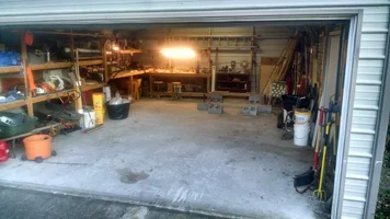

All I know how to splice is 3-strand, but it's a damn gateway drug. I'm itching to try my hand at other stuff. Been filling cart with splicing stuff. Planning out bench arrangement and construction in garage. Reading these damn forums. Prepare yourselves for lots of dumb questions when I get ready to start.

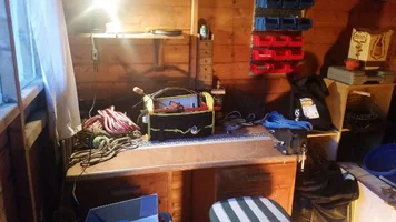

I like sitting on my high-topped stool. I also like my wood-working vice at the end of the bench because I can use it to clamp almost anything, including the end of the core or cover, the end of the wire fid, or the metal post for 16-strand splices. I screwed the post to a short piece of 4x4 so I can clamp it into the vise when I need it and store it out of the way when I don't need it. The main thing is to anchor the bench so it will not move when you pull hard to bury a 16-strand splice. If you can't anchor the bench, then anchor your cleat to something else that will not move.
