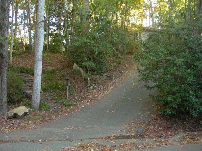

Here is the driveway

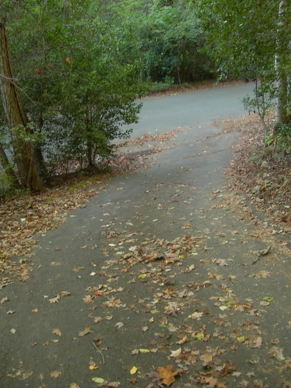

This is looking down from the middle of the driveway.

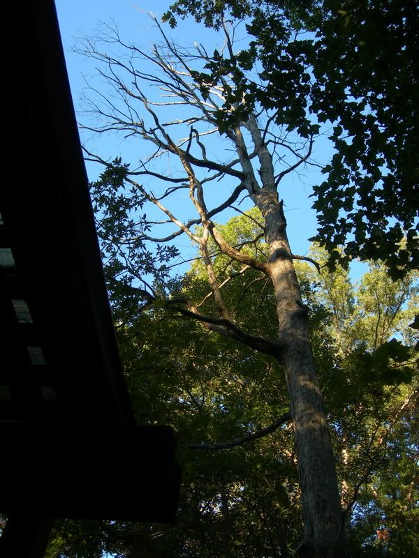

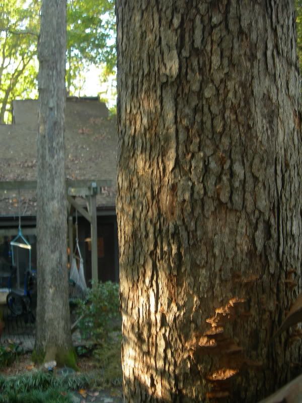

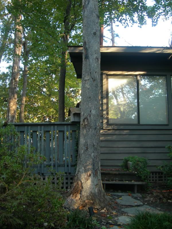

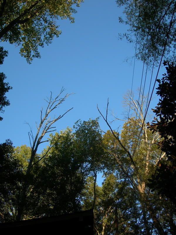

This is a series of pictures that show the extent of the death involved with all three of these Oaks. One is hovering over the house, the other is over the guest house, and the largest is near primary power lines. Oh my.
Again. Big time importance in getting the crane up the drive.

That said, the driveway looks like it may be possible for an ATV, maybe even a 70 ton like the one shown in NoBivy's photo, to get in there. Though I'm not sure that particular one has the adjustable suspension like Mr Ed mentioned, which may be very helpful going up a slope like that. Good luck, whatever you do. Prepare for shrapnel. You might hang from a basket for a little while getting some floppy deadwood off, if there's anything that might get broken by falling deadwood (like yourself). You could do the breaking cut that Reg mentioned in another thread, but still, if there's a house under it you probably don't want big dead limbs falling on it as the tops flop off.

We will be doing something similar over the houses and the power lines. Actually, I am getting the local utility to clear a couple of the limbs over the primaries in the Red Oak. Every little bit helps.
We are scheduled to start next week, and I can't wait to see if we get our boom truck up that drive.

Call another AT operator...that dont look to bad. Hard to say not seeing it in person though. Those trees a MO-dead....be careful. Why the hell did they wait so long?

Looking at the pictures I dont see a need for dunnage. Is it to keep the back of the crane from bottoming out at thhe transition from road to driveway. I would think a truck crane could drive up that.
I am in Hartford, for the TCI Expo
The job is well on it's way, and the boom truck made it up the driveway with very little drama.
