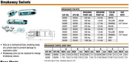

The other day at work, we were pulling (through conduit) wire which has 61 strands of about 1/8" copper in the core (about 1-1/8" diameter) with a thin layer of plastic insulation around that, then a layer of rather foamy insulation about 7/16" thick around that, with another thin layer of plastic, then a copper foil wrap, then an 1/8" outer plastic jacket. A total of 2.35" diameter (type MV-90 EPR 1000 MCM). Three "strands" of this plus a 7/8" bare stranded ground wire in a bundle, 4 each of the total bundles were pulled separately. One pull length was 650' and the other pull length was 350'. The "basket type" pulling tools would be wholly insufficient for that!
Attached is a portion of the Greenlee catalog page depicting the breakaway swivels.

I'll be able to find out tomorrow, I'm sure. One thing, Tom: even the small end would make one helluva projectile, but I suppose a couple of fingers off some old gloves could be zip-tied around it to make it mostly a bit cushier. I'd imagine they're stainless steel and will guess no less than 100 bux -- we'll see.

I like that term "mechanical fuse." That seems to be exactly what we're looking for here. And the ones glens looking into....hmmm...these show promise!

I dug out my old contacts and gave one of my old suppliers a call, boy, was I wrong on the cost of the breakaway. The breakaway swivel glens and I have been mentioning from greenlee costs $230 for the swivel body and another $25 for the pin kit(10 replacement breakaway pins). Pretty darned expensive for something that's instance specific and very rarely used.
