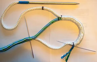

After doing 5 eye splices, I agree that this will be tight. I just posted the following tips and photos on TH which might help you. Look at steps 3 and 4(and the photo I posted). I found this helps to keep the cover bunched up to help squeeze the fid through on the step you are working on. Also, I would love to hear tips other people use for splicing:
Tip #1 Using 7" double-point knitting needles for isolation:
I find that these work quite well to isolate portions of the rope for the following things while making splices.
1- Pick up some 1" painters tape. This works great for taping and is very easy to remove.
2- You can use 2 needles to pry the cover apart to help expose the core for extraction. First insert one needle between the cover and the core in one direction and the other needle in the other direction. Then rotate the needles until the core becomes exposed.
3- After you extract the core and milk the cover all the way back, place a pin at the extraction point so the core will stay exposed and not slide back into the cover.
4- When you thread the cover from through the core and back out again, place a pin at the extraction point so the cover will stay exposed while you make the taper
5- After you insert the cover into the core and then taper the cover, wrap the tail of the cover with some tape, then place a pin through the cover just above the tape and through the core to prevent the cover from accidentally getting buried while you work on the next step of threading the core back into the cover at the crossover point.
Hope you are enjoying the splicing. Post some any ideas to make it easier...
Michael

Also, I agree with Evo. It definitely helps if you open up point 'Z' by feeding the fid through in 'opposite' direction. The double-point knitting needles help at this step - the needles are cheap and come in a wide range of sizes.
Good luck with your splice. Be sure you take the time to "completely smooth out the crossover point again just before you complete the final bury" !!!
Send us a photo when you are done !
Michael

I also use knitting needles but for opening up the rope to extract the core I use a pair of surgical "snap ring" pliers. I had them laying around for body jewelery, my old roommate was a body piercer. They are super tough and I frequently will only use one side to pry out the core, I've broken knitting needles by trying that..

Take another look at the first part of step 8 in the Samson instructions. Before you start your final buries, go back to the crossover point at Mark T one last time. start on the cover side and milk it smooth. then do the same from the core side. you may need to do some massaging right at the crossover until it is smooth without any lump at the crossover point.
For the second part of step 8, I found I needed to spend a LOT of time massaging the fid from Mark X to Z. It was very tight and needs to be slowly stretched out to fit the core through
Next milk the cover into the core at Mark 3
Next milk the core into the cover at Mark Z.
Now you are ready do the final bury.
Using those needles to pin everything in place helped me with isolation while I worked on the other sections.
I have been very fortunate that all of my splices came out good. Don't worry. You will get through this too and put a smile on your wife's face. Good luck.
