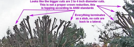

Hollen's got a good point. The issue is adherence to a Code of Ethics not a rule. Could that have been a crown reduction? It looks like it to me.
I just did a crown reduction on a Norway Maple that had 3 of it's 5 leaders topped badly. I reduced the remaining leaders as the client was concerned over the breaking off of limbs that had occurred. The tree has Verticillium wilt so I explained to the client that the reduction is a temporary measure and the next step is removal.
It's difficult when a significant piece of business is offered. Could you have spent more time explaining the difference between the crown reduction and topping and the subsequent benefits to the trees and client? That may have justified the additional cost and allowed you to develop a portfolio of proper pruning practices to showcase to others.

treehumper, I wish it was a proper crownreduction or even close to something like that.
Maybe your computer screen isn't showing the picturs as large as mine is.
There is no cut back to a lateral, everything ends in a stub cut.
The cutting point was only dictated by a geometric shape, nothing to do with proper ansi pruning.
I am not calling names here, I am not being rude. Unless rude is not agreeing with someone.
attached is his same picture, but just a portion of it so the pictures comes zoomed in closer for you.

ANSI A300 2008:
4.51 topping: Reduction of tree size using internodal cuts without regard to tree health or structural integrity. Topping is not an acceptable pruning practice (6.1.7)
6.1.7 Topping and lion's tailing shall be considered unacceptable pruning practices for trees.
<u>ISA Board-Certified Master Arborist Code of Ethics:</u>
II.C.9.
Responsibility and commitment to act in a manner consistent with all generally accepted professional standards.
Isn't ANSI A300 a "generally accepted professional standard"?
Do not promote topping.
