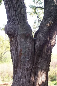

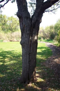

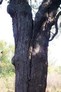

We had to brace this oak. The split went almost to the ground. We installed 4 steel support cables and 3 bracing rods. The branch union was too wide to put any bracing above the union. We used a 5 foot drill bit below the split.

The bolt looks too small for the job it's being asked to do.
They do look small, and the o rings you used on the end also look small....is that enough service area to stop the rods from pulling into the wood??
Norm did you prune any weight out of the crown? it looks very heavy.

The rods are 3/4". The tree was pruned prior to support cable installation.
We can't guarantee anything we do. We tell the client the truth. We have had extremely good luck when reducing weight, installing support cables and bracing in a scenario like this.

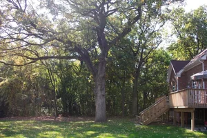

Nice work Norm. What kind of oak is that?
What size and type cable and end hardware did you use?
Were the rods lag thread or machine/coarse thread? If they were lag thread how did you turn them through the tree? I've seen and used several methods.
The pruning was done with a bucket. The cable was 5/16" EHS steel, 1/2" eye bolts for the anchors and coarse threaded rod for the bracing. The hole size was 11/16".
I was not in on the pruning. I was called to help install the bracing, the support cables were already installed. The question was, how to install above the branch union. In my opinion, the bracing would provide the best support if installed below the split.
