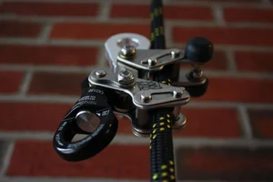

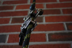

I now make the BOLA (which I call the SS BOLA) with a stainless steel spine and pin on the teardrop (or optional nano swivel).
The arms are also SS and the friction links are nickel plated. The teardrops are 7075 aluminum, with nickel plated brass bearings. The rubber nubs have a SS stud, affixed with a SS jamb nut.

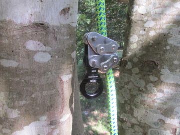

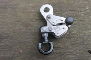

Thought I would post a picture of the BOLA with the swivel. This model would not accept the swivel before, but by changing the profile of the lower swing arm, it now does. It is 2" x 3-3/4" overall in size.
Gotta get my 11 k max so I can retire my prussic climbing ways
Both style BOLA's will accept the swivel (as pictured), but the early style does not develop as much grip.
The SS BOLA does not have to have the teardrop on top (as pictured), however with the teardrop at the top it is very easily made to self advance by terminating the standing side of the rope there, plus the climber can isolated himself from the circle of the lanyard in case of a split in the stem. The teardrop is made of 7075 alloy aluminum, and on the BOLA has a nickle plated brass bearing, so the teardrop only weighs 1 oz.

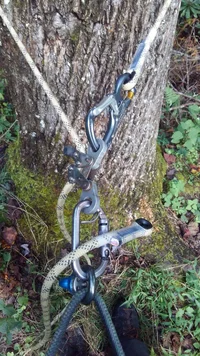

Here is a Japanese climber with 2 Bones and a BOLA on his lanyard. It looks like 1 Bone is on his throw hook line.
Interesting how he has a quick link in there. I haven’t seen one rigged like that.
