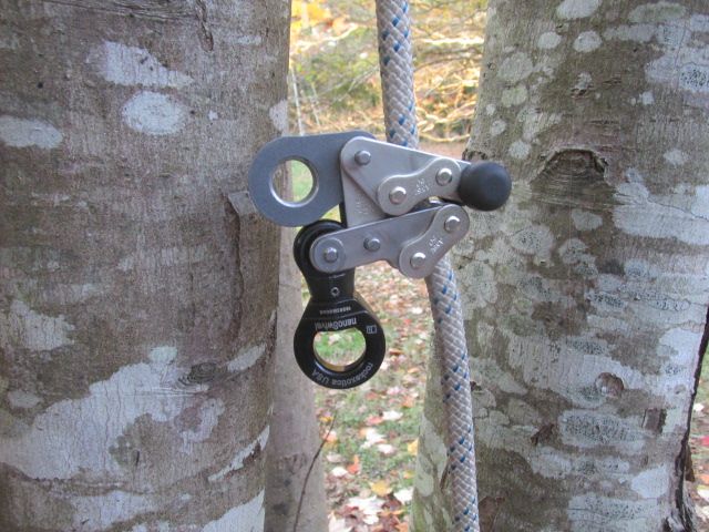

Bone style BOLA, has more bite. Releases with the top arm only and takes more force to release when fully weighted.
It does with my weight and using the KMIII (7/16)
It does not release as smoothly as the Bulldog Bone when fully weighted,
I think because the pins are .234 dia. rather than the .312 pins on the Bone
However, if you add a teardrop attach point at the top, it will self tend much like
the Unicender on a doubled line.

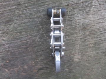

Picture of Bone style BOLA with teardrop at the top also, This would isolate the climber from a barber pole split. It is just over 3 inches from centerline of teardrop to centerline of teardrop.

Haven't climbed on it yet but this thing is sweet! tends smooth, but not slack gobbling smooth. release is very intuitive and is smooth as well. seems to hold my weight and descend smoothly srt as well. Secondary attachment point is great. looking forward to climbing with it tomorrow.
Btw I'm using it on sterling tritech, not sure how other ropes work in it.
Thanks Nick, I used to have the Tritech (from Steve) and it was one, dense,stiff, tough rope. I would think it might be too grippy, but pleased to hear that it seems to work with this Bone style BOLA. Tritech may actually release even nicer with the regular wide BOLA.
Climbed on the bola today. deadwooding and pruning some large scarlet oaks. really enjoyed the lanyard setup. I used it in all configurations, it performed great. I will say that when using the top attachment point it tends to add a bit of friction to the rope, nothing to be of any hindrance, just makes things run a bit different. all in all this is an excellent device and well worth trying out. Kudos Gordon!
