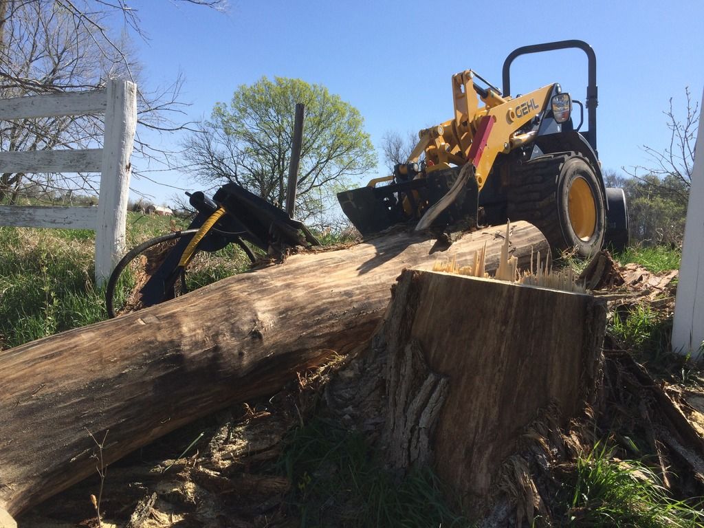

Nice video, the 540 is a beast, my favorite in the lineup.
Just a FWIW, I put a go pro mount under the roll bar... makes for a bit smoother video:
I plan to do that soon. I have a hard time even stopping to take video.
Carl, the BMG on this is having a real hard time. Dave had to send me a third one to fix problems from the first two. Have you had any problems with yours when you were using the HD?
The 540 reach and height is way higher than on my old asv loader. It makes it easier to put the little stuff on top once you get the big logs on the bottom.

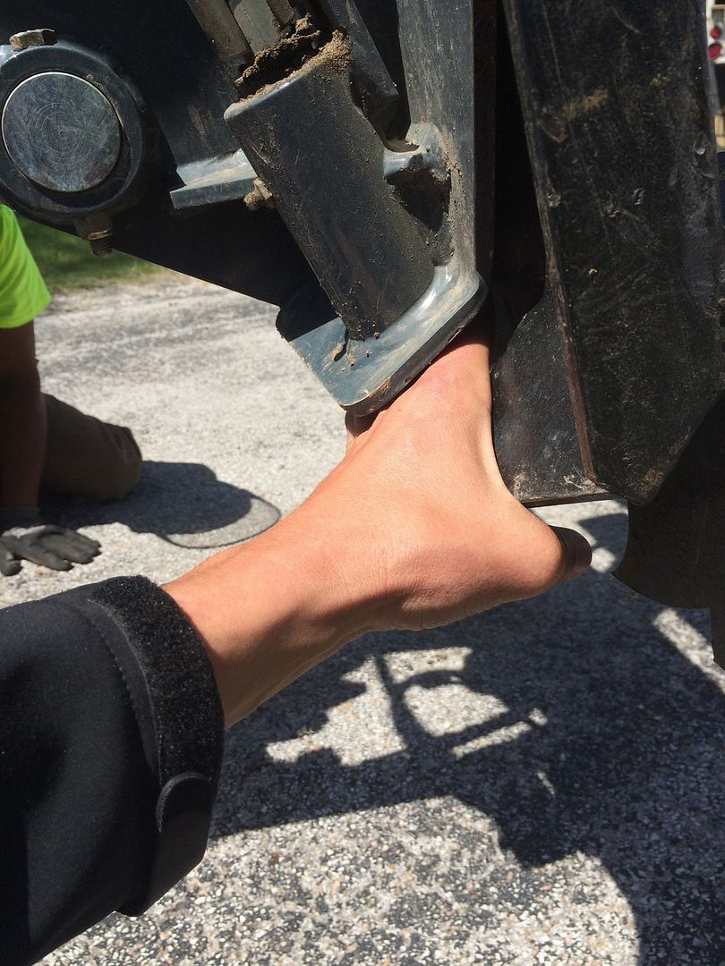

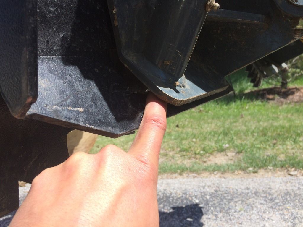

the replacement back plate for the previously bent one was made poorly and there was so much slop in the mounting it has allowed the whole grapple to start falling off. I guess the angles of the bottom part on the attachment plate were off. Dave is taking care of me as I am still within my warranty period on the grapple but I feel as if I am doing the company's R&D for them. Why I never get notified of these known defects is beyond me.
That plate was missmade, not a design defect but a manufacturing one. No good excuse for it. The only design defects I've seen are what I listed.
Do you have a picture of the front of your grapple hanger that bent?
That was from the first BMG HD I bought last year. This is the replacement one having issues right now. As they say, "Third time's the charm..."
Dave sent me photos of the new one and the back plate got beefed up even more. He said the Gehl 540 was still bending some peoples plates.
We had the exact same problem with the hd bmg hanger on our 540. The good news is that your in good hands with Carl and Dave and newest design has been bulletproof so far.
