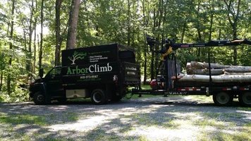

GMC 4500 or 5500 with a 6.6L duramax diesel with an allison transmission. Get it with low miles as they are know to have head gasket issues at around 100-130K miles. You would be very impressed with the power they can produce.
Nice setup Royce.
