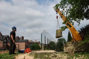

This mature beech was condemned because of a crack at the union of co-dominant stems low down, that and its position sprawling over the playgrounds of two neighbouring schools. The pruning and bracing option was rejected by the tree owner.
The 10t city crane was the only one we could get in through the gates....as well as, it came to light that the tarmac was only set on a couple of inches of hardcore, so even with better access we’d have had to boarded the whole access route to drive on anything heavier.
For anyone who hasn't done crane-work, the problem with small cranes in that you often have to set up very close to the tree relative to its height, and in doing so it’s often difficult if not impossible to manoeuvre the boom through the outer-facing foliage/branches to sling the tops, especially since this particular crane has a Boom-Extension-Wire which is always a major cause for concern in the event of snagging and breaking it with a branch. So a little more thought and strategy is involved i.e. seems as the boom is already near vertical the picks can only be slewed left or right, so similar to conventional rigging space must be created here and there to make room for what will follow in the most logical sequence.
Then there’s the reduced load capacity where normally you might look to leave lots of limbs still attached, sometimes purposely to balance out the logs, but now you might be forced to pick the limbs off the logs because you don’t have the capacity to do both and big enough to balance.
Even riding the ball can be very inefficient where many horizontals must be picked singularly i.e. it is often quicker to strategically leave high tie-in points (but low enough not to obstruct the boom) and just be there at the next slinging point when the hook returns....I had to mix it up on this job, as much forward thinking as could muster to keep my climbing to a minimum, but even small cranes beat the hell out of manual rigging....and apart from being sick all week I was still pretty fresh at the end of the day.
Lots more picks than what Ive shown, but I think there's enough here to set the scene.
The other guy in the tree, Ken, actually came down from Scotland just to watch, he’s also a contract climber but wanted to get a taste of crane work....good for him I say.
30+ photos to embed so its going to take me an age to finish this post, but still much less than making videos. Thanks.

Nice again Reg, IMHO it takes a lot more skill and careful weight calculation to work with smaller cranes (several buzzers come to mind) with my first li'l kboom If I went 50 lbs over max the thing would start slowly bleeding off, with the 55ton effer it made a huge difference, now with the 175 ton effer I don't even have to think about weight on 80 percent of my picks! Reg, did the OP let a couple of those swing too close to You or was it the camera angle?
Thanks, took me an houe and a half to embed on the forum, almost as much concentration needed as the job itself.
I think the photos just show it being moved away couple seconds after Mike, not swinging anywhere. Many times the crane op hasn't realised Ive even made the cut....I often look down to see him texting while its just hanging there!
