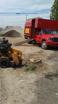

Here she is with the bed off. Not ideal, but she's about to get spiffed up big time.
In the third picture you can see where the frame dips down, the curved "s" rail that attaches the front to the back is an area I really want super clean. I've come to understand that this specific model truck will have the frame crack in this location. They modified the frame at the manufacturer to accommodate for 4x4. That's the area I'm most concerned about reinforcing/getting all the rust out of. The 2wd models just have straight rail. That's going to get super beefed!
Plan is to have 3x8 platform right behind the bed for diesel tank and toolbox. Then an 8x8 platform for mini and plywood/mats which will sit approximately 6" lower than the 3x8 platform. That will make loading the mini/mats more convenient, and eliminate an over the top subframe to accommodate for the dip in the frame. As well as make mounting the bed a bit simpler.
Anyway. The steel is ordered and I'm in the midst of sandblasting/painting quotes. More coming soon

Just dropped her off at the sandblaster. Got a quote for initial blast. Then blast again after the frame is beefed and new bed frame on, plus two coats of primer for $1000. Thought that was pretty cheap. Supposed to pick it up Monday to bring to the fabricator. Pics coming soon!
Took forever to get my guy to do it, but the bed is finally on! The plate that was on was micky mouse BS, so we cut it off. You could see where someone had also micky mouse- extended the frame a few feet, so we cut that off and put new rail in its place, along with a 5/8 plate for the hitch. There is a 3 x 8 section just behind the cab and 8 x 8 section further back. Going to put some rough cut boards on her after sandblast and paint. Then wiring it up will be fun, I'm sure. Might just pay someone to do it. Busier than ever.
Also reinforced the frame and put a few cross members in between the existing frame rails to beef it up. I'll get some photos of that next time I see the truck.
