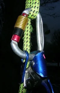

In answering your question about using a tibloc to back up <u>single</u> ascenders SRT, I have a picture of that from about 4 years ago when I was trying out the Tibloc as a backup.
Here's the first picture:

Here is the second. As you can see in these two pictures, it is a Kong dual-handled dual ascender, but only one side is being used.
Because the ascender top hole is twice as wide on the dual ascender, a caribiner won't fit through it, but a rated stainless steel slideline caribiner will fit through the secondary hole at the top of the ascender. The regular top hole accepts a captive pin (in the United States, called a power take-off (PTO) hitch pin ) for additional security; it prevents the rope from ever being able to escape the ascender shell.
On a single ascender, a caribiner through the top hole, connecting to the Tibloc is very direct, and the rope is blocked from any possibility of escape I probably have a picture of a single ascender linked to a Tibloc. I'll have to look.
What other questions do you have?

Actually, the non-locking stainless biner will fit through the top hole of a dual, but only through three of the four plates.
This picture is shown attached to a Tenex eye-eye tress cord with a VT as backup.
A setup in this fashion is shoddy. Shoddy means less than ideal. the caribiner should be a locking biner, but no locking biners I tried would fit through the top holes of a dual (too big a diameter or not quite the right shape).
