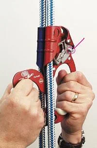

Simple ascender safety addition
If you are using this sort of ascender, a carabiner with a circular cross section can be placed in the uppermost attachment point closest to the cam and it will ensure the rope stay in place. Its the same hole in the illustrations used for having the ascender "pull along" with you. Make sure you put the carabiner around the rope rather than in front of the rope.
Heres a link with an example- a simple kong oval carabiner through the upper hole of a SRT (australia) handled ascender...on the way up into the crown of a 90meter euc viminalis.
By the way, I try to avoid that girth hitch into the bottom handle...even though its strong as the ascender teeth it still wierds me out.

Re: Simple ascender safety addition

I don't think that both of the top holes can be clipped with the doubled Kong ascenders. I could be wrong. Would someone who owns them check? If a biner can't be used as a lock a pin could be used like the spring pins on Gibbs ascenders.
Your right about the biners. I don't own one biner that will fit through both holes at the top of the Kong double ascender. I tried petzl william the oval petzl, DM Whales, Faders, Black Diamond, Mongoose, petzl attache. Anyone else have a biner that fits?
You can push down on the cam and it won't remain open but if you push down on the lock out latch it could conceivably get pushed far enough into the locked (open) position.
You could disable the latch or just use your head like you do with your hitch and keep it clear of branches.
