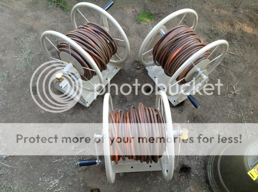

Very good questions Steve.
There's no doubt that my system is a very poor and limited imitation of true fruit burdening that occurs throughout the entire wood structure naturally.
However limited and poor this system will admittedly be, it does make physiological sense in the logic behind the reaction wood triggering process it mimicks so poorly.
And since the other two reels for this first prototype just arrived today, and no plants have yet been hung in any location in the Tipu tree?
I would ask you to be patient enough to wait until you see the finished installation and where the plants get hung from to determine whether they are optimally located to strengthen as much of the leaders as possible without risking branch failure?
I'm thinking 3 inch diameter lateral is good for up to 50 lbs, effectively a 25 lb hanging plant coming off the pulley.
I plan to start installing this system on Thursday.
I'd also like to thank Tree Frog for suggesting rated steel cables be used in this system. Because small stainless steel cables inside the water delivery lines would be an excellent way to increase this systems durability and longevity before any replacement lines are needed.
But that'll have to wait until the second prototype is put together.

Here I am on Thursday, buying hundreds of feet of1/8 inch OD plastic coated wire rope to thread inside my 1/4 inch ID braided polyethylene water delivery lines, just to be on the safe side of professionalism, despite the increased cost in materials time and labor.
Each reel has 4 fifty foot lines coming off them. So by threading one hundred foot plastic coated wire rope inside two hoses through the reel axis itself, I can thread 4 fifty foot delivery lines with 2 one hundred foot cables.
Reminds me of the old Sneaky Pete automotive crank seal replacement tool.
Thanks a lot Tree Frog, for "spurring" me into action....I think?

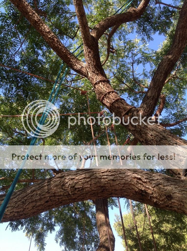

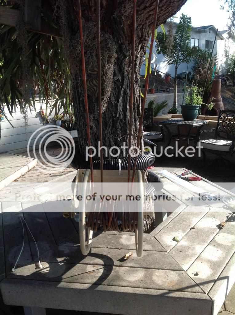

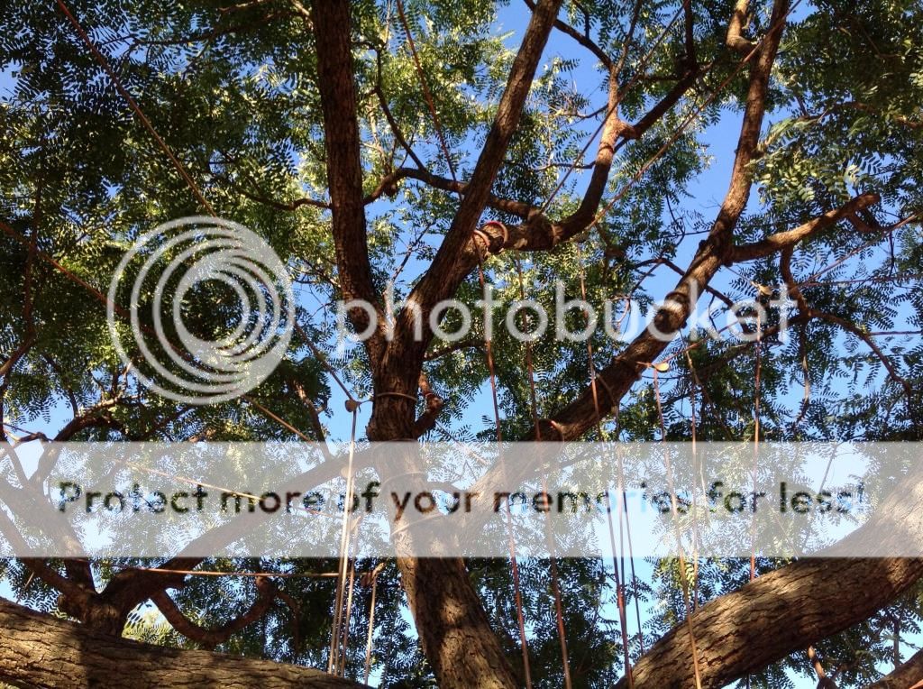

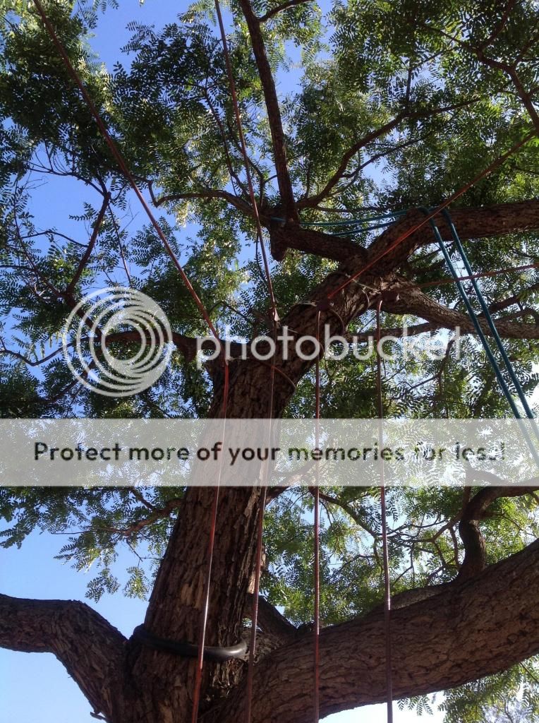

Well I'm one third through this project today.
There are two heavy duty tension springs inside that black corrugated tubing to allow for trunk diameter expansion. Sets of two in each tube for a total of four.
Way more complex than I initially envisioned.

Jomoco, you are one truly creative cat. You are probably already aware of that! I get a kick out of your energy and enthusiasm. You sure do realize a great number of ideas. Keep it up!

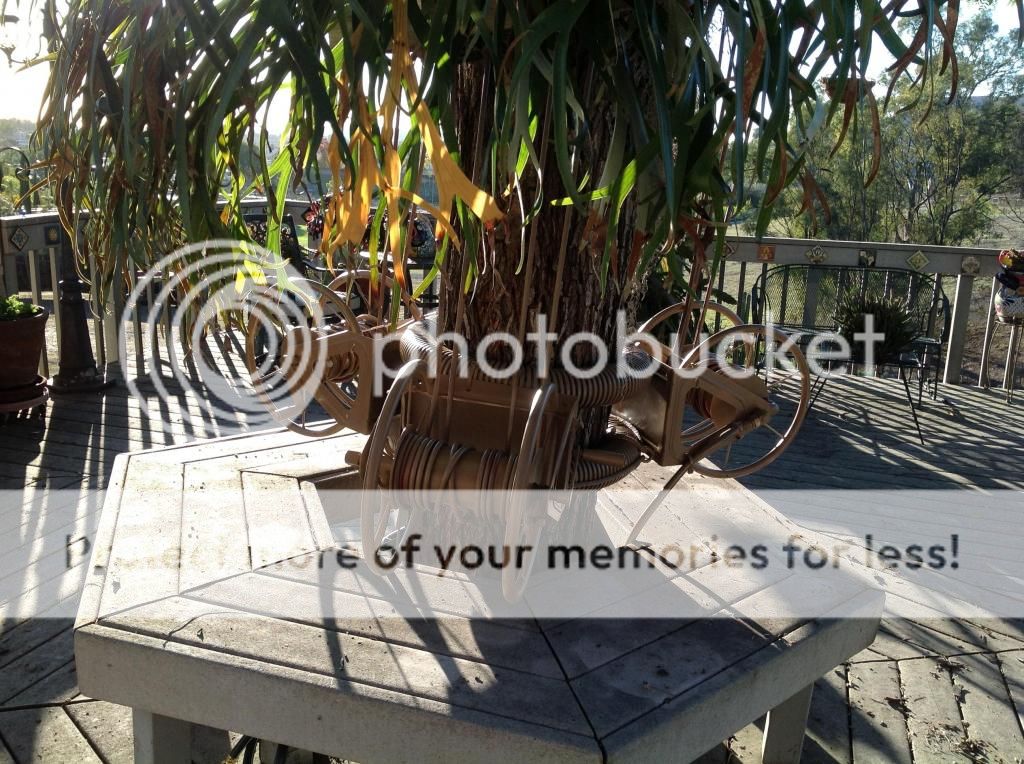

Thanks Oceans.
I'm pleased with the system, but more importantly the client is very happy and satisfied.
However to truly do the system right, to the point that a frail little old lady could swap out plants with no problem?
Each reel needs its own ratcheting mechanism, as well as a 5-1 gear reduction unit.
A manual boat trailer winch with a huge reel?
Fortunately this client has a very capable husband and young son to do the plant swapping when needed.
I'd like to do a really big tree with stacked and sequentially staggered rows of reels encompassing the entire base up to 12 feet up. Maybe a huge Torrey pine in La Jolla?

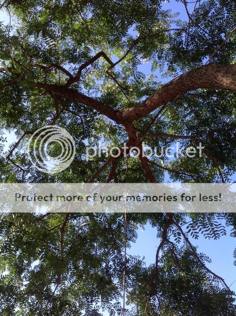

I just now found a free PDF link to a subject I find fascinating as well as pertinent to my project, the natural welding together, or grafting that occurs naturally in many tree species.
http://naturaculture.sites.go1.com.au/si...f-Myrtaceae.pdf
I love the idea of forced grafting of crossover branching to enhance a tree's structural stability.
For instance, this Chorissia speciosa has a small leader on its left side that arches back enough to crossover the tree's dominant central leader. That crossover is only a little over an inch in diameter compared to the central Leander's diameter of 3 inches.
I want to drill and fuse those two branches together with either a plastic or wooden dowel, enough so that plastic washers and nuts can mechanically squeeze them together long enough to promote their fusing together sooner than might occur naturally over time.
This contradicts many pruning standards, which may be why it interests me so much!

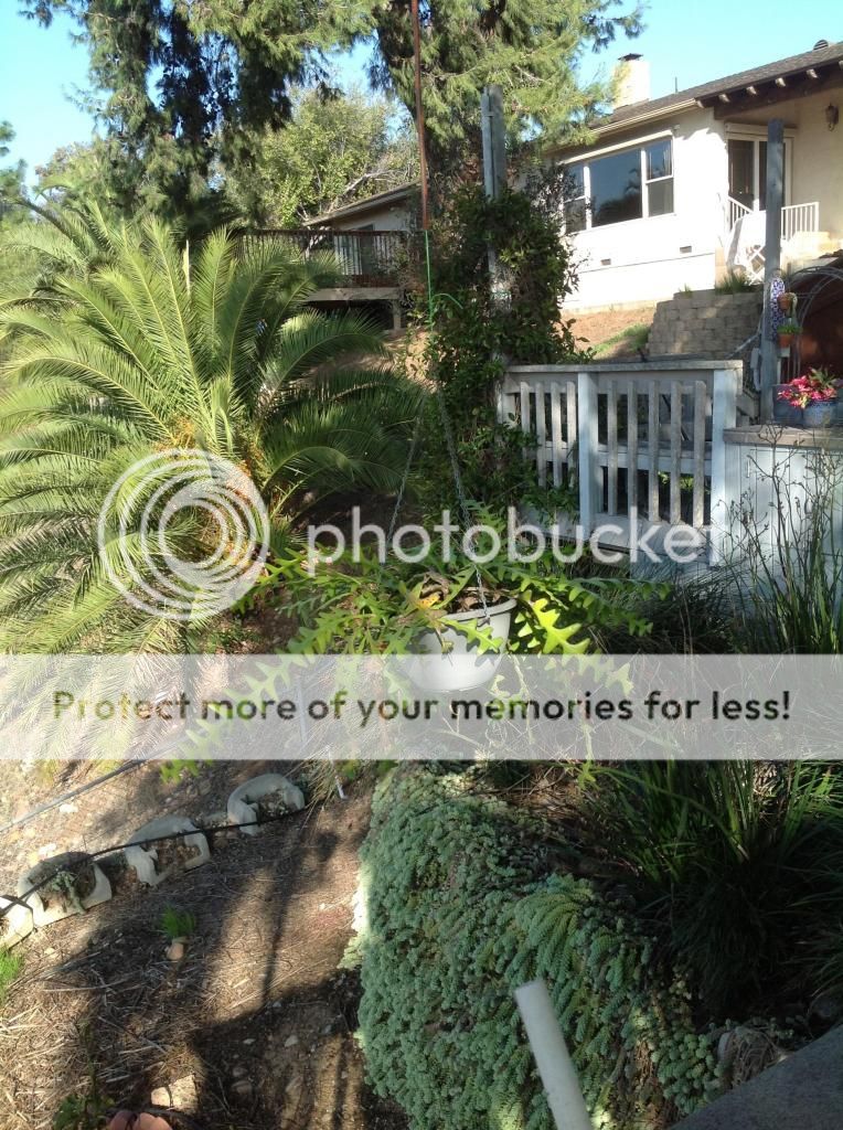

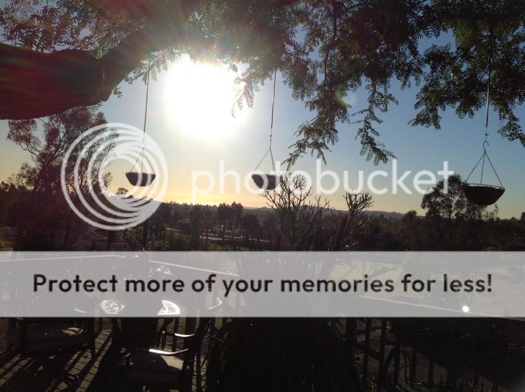

Spring seems to have busted out in all its silken glory today.
I think it's safe to assume that after these heavy seed pods have cast their weights to the wind, the branches will rise a few inches, as the process of branch structure strengthening through weight burdening takes its natural course so gracefully.
