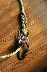

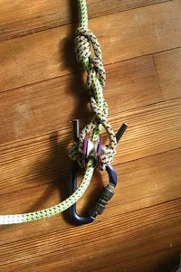

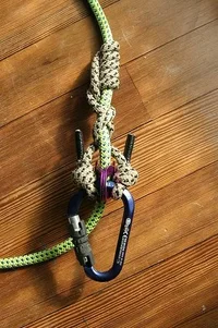

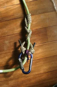

So you just twist the legs of the hitch before the braids, making it grab more consistently? I remember doing that with some crispy cordage in the past when it would start slipping. Definitely works.
4 of 4. I actually do my "full" braid at the bottom. These pictures show the full braid right after the 4 wraps. You can do the full braid where ever you like you just have to do a sit test before you really climb on it.

5 wraps. I cant count. Speak up if these are your pictures. I would like to give credit where it is due. I always have trouble getting photos sized right so I'm lazy and just archive stuff.
