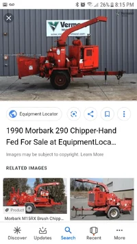

I have a morbark model 290 12”chipper. I have replaced the blades and anvil and the gap is much different on the inside and outside blades on the disk. The machine runs smooth with no shaking and has decent power with the Perkins engine. I previously had the same chipper and never had this issue and it almost seems like I need to shim the blades. Do you even do this or any other thoughts on where to start would be much appreciated.
