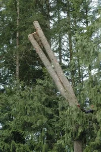

Gord, looks like the butt came back a little.
Doesn't look like any stump shot but I'm just going by the picture.
