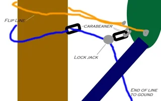

Also, in your video of lanyard techniques, when you were first giving the example of a 2nd tie in point for blocking down material.----- DO you think my illistration (see attatchment) would make for a safe situation?
Thanks
DanielSon

It would work if the biner of the climbing line was attatched to the lock jack. The way it is illustrated the lock jack would not work. I would keep it simple and cheaper by using a rope for the split tail and tie a knot you are familiar with already.

is that safe to have lock jack as your only life line?
I would say yes, it's simply a replacement for a rope hitch, however in that diagram shown I'm not sure if the Lock Jack works OK SRT??????
No, sorry but I cant agree with
1/ Cross loading a carabiner
2/ Having the potential for the rope to be on the gate if the carabiner rolls over/turns over
3/ Having the gate rubbing against the tree
Here are benefits of tying a bowline
1/ I would say most people proficient of tying a bowline would do it under 10 secs
2/ You dont have to buy a carabiner
3/ You can have a long tail tied on the bowline so that you can move down the spar say 15' with the choked highline in place to assist your balance and then retrieve the choked bowline.
4/ It's one less thing in your system to go wrong. KISS principal
Replacing that knot with a carabiner or snap hook is not as safe IMHO.
