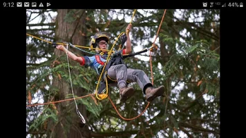

The timed event was a rebelay. We ascended 30 feet with a backup line with an asap, set up a descent system (rig or ID were standard) with a backup, moved our ascent system towards our anchor across the span with backup, traversed about 50 feet, switched the descent system and backup to a descent line, pulled off ascent gear, and hit the dirt.

This is what you look like on the rebelay, though. She's actually pretty tidy there. It was a tangled mess.
