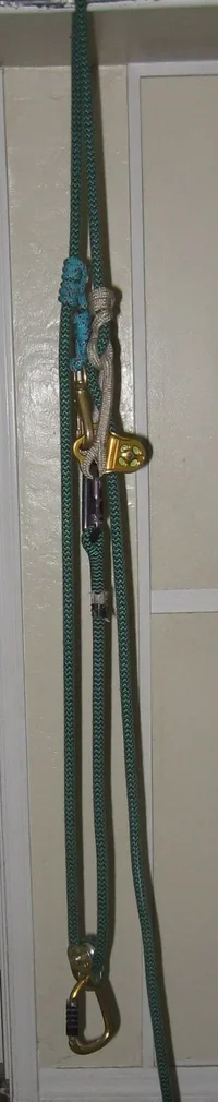

Adjustable climbing system
Here it is in extendo rocket mode.
the small gator biner was shifting a bit.
This dog snap solved that.
Any input is much appreciated.

2 concerns:
1- The dogsnap is part of your safety system. If that thing goes, you are in for a nasty drop of a few feet. Maybe you could install a quicklink?
2- The splice on the brown line. Is that HRC? If so, was it spliced like a traditional double braid rope?
Other than that, the system looks quite sound and clever.
love
nick
Nick, 2 things. I don't see a brown line? Also, the dog snap and small prussic aren't part of the safety system. If they fail, all that could happen is the relative position of the friction hitch assembly could move up or down.

I've done it with throw line cord for the extender prussic.

From a safety standpoint, I like this last rendition much better. The girth hitch is a good idea. That oughtta keep 'er in place.
Is the bottom pulley needed? Would the system work the same without it?
love
nick

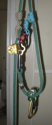

I added the pulley so I can extend or retract the system with my weight on it. It actually works fine just through a biner but Im OCD so I just cant leave well enough alone. I did however like the way the pulley seemed to put less stress on the spliced eye on my climbing line when the system is retracted all the way.

The ropeman just moves a little faster than a prussic. Thats probably only better for competitions. I think the system takes to long to setup personally. I use a modified Anchor Bridge during the work day that can be removed and stowed if it gets in the way (never does) or reinstalled in seconds for a long ascent.
I've heard rumbleings that the ropeman causes rope damage, I'm guessing to the core, because of the tight pinch that a smaller Biner causes between the ropeman and the ascender that attacks the ropeman
Def. A gear intensive system but very efficent. Great idea with the pulley to bring the ropeman back and forth under tension
My guess would be damage to the cover from the cams biting into the cover, not the core. Just a guess, though.

the cam isnt toothed nick, and hasnt shown any signs of wear on the cover, but there is a bad bend in the rope where the ropeman and binet connect, much worse when the users weight is applied, if you look at the pic, you can kinda see it,
I switched to an online prusik and haven't had a problem, I've also used a microscender, which worked great, but a little cluttery and bulky
