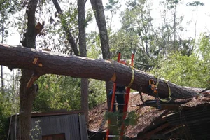

Is there a bottom cut on that branch, I can't see one in the picture?
Here's a Red Oak branch that I cut.
Here you go.

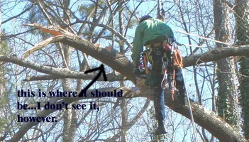

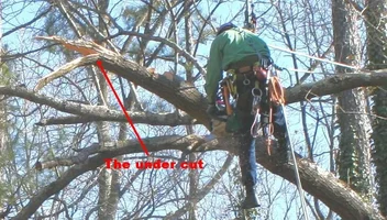

Nah, I wouldn't have it that far out...I have had them as far apart as 2-3 inches but not feet. I am trying to get them basically overlapping now. Here is where I THINK I had it...but I can't see it. I'm thinking I just tried cutting this one straight thru, fast, to see what would happen...the DZ was clear, no worries about just dropping it.

I think you mean this...if you don't want to watch the whole thing, I think you are talking about what I did at about the 2:00 minute mark...are we talking the same language?
Although, I didn't use the side kerfs...I think I did it more like Rupe.
