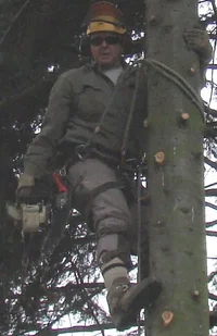

Here's some climber stripping off the limbs on the way up. Plywood on the roof kept the raingutter intact. The lawn made a nice drop zone.
Close-up of the climber. All righty, let those comments about one-handing the 020 and the 046 fly.

I wont bash the one handed technique even though its not good. If you do use that technique you shouldnt "burp" the throttle as it offers more of a chance of kickback, as does dragging the tip of the bar in to the cut as it goes over. You should just cut full rpm straight thru if it was an accepted practice.
There was no need for that cut and push technique on the top or the sections of timber. As for one handing the 46 in that situation - it looks very dangerous and the kind of thing that only the village idiot would partake in. Or its the kind of thing a climber does cause he knows he can get away with it....cause thats what treework is all about...knowing what you can get away with.
Overall I'd give the climber 3/10 for performance, with 10 being the best possible score.
With a little practice, you could get those pieces to land flat on the ground. Then their is less divots to fill in. Kinda rough IMO. I only say so because it must have been shared for critiquing.
I've one handed when chunking rounds or sections for as long as I've been doing tree work, just like Mike did, and does.
It's all about production.
As safe as proper two handing? No.....but doubtful that an experienced cutter will ever have a problem.
I do try to make em land flat tho...and use two hands as much as can be easily done.
