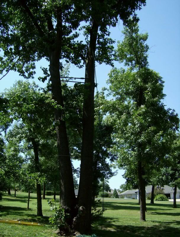

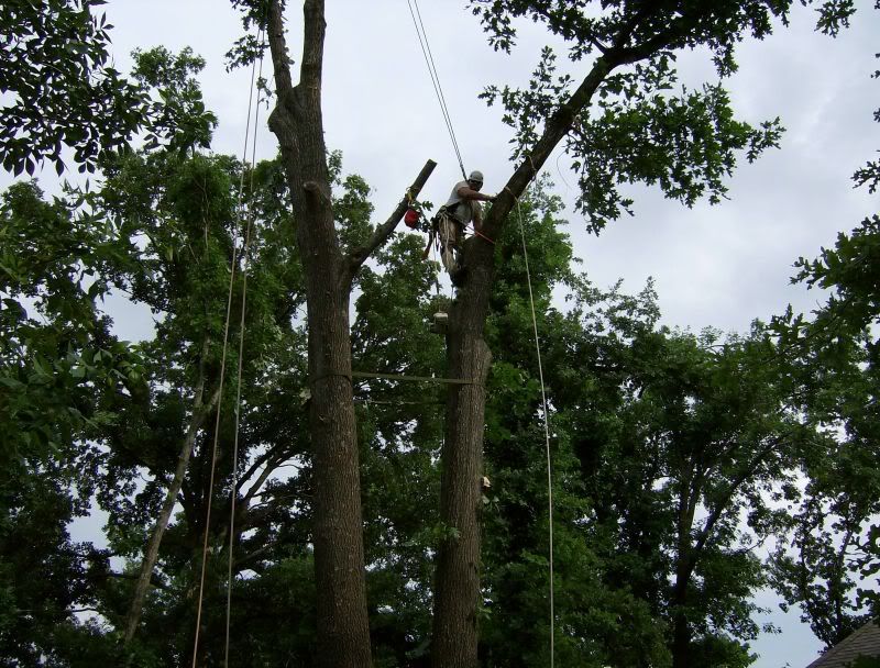

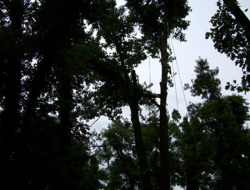

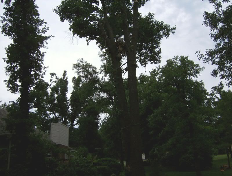

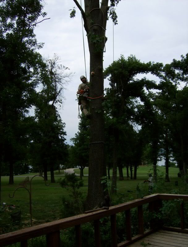

A few of the tree we took down yesterday. I snugged it up and braced it with a come along, log chain and ratchet strap before I rigged off of it. Had to lower everything off the left side because of septic system and leach field.

why didnt u just tie the right side off to the left side and butt tie it and notch and let it down slowly with a figure 8? soo much easier

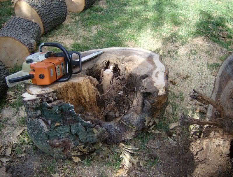

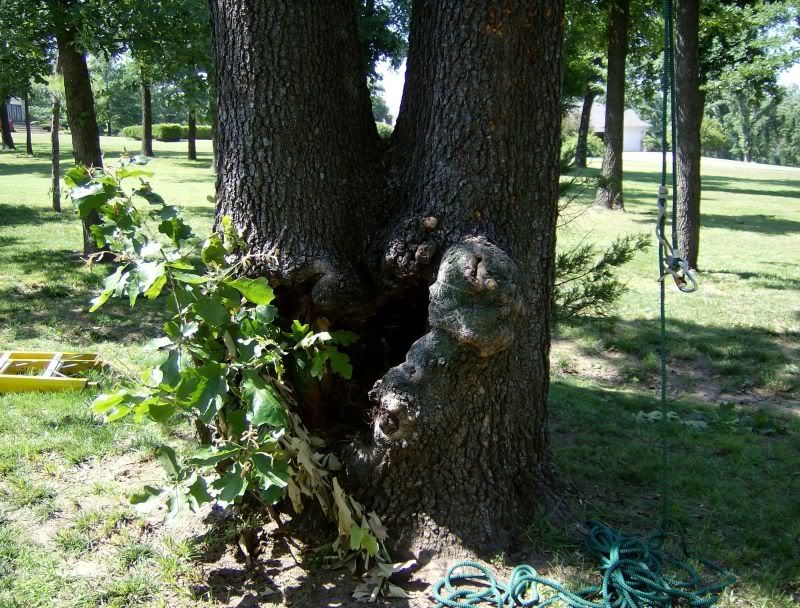

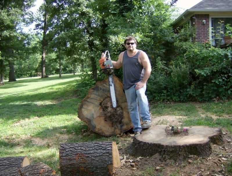

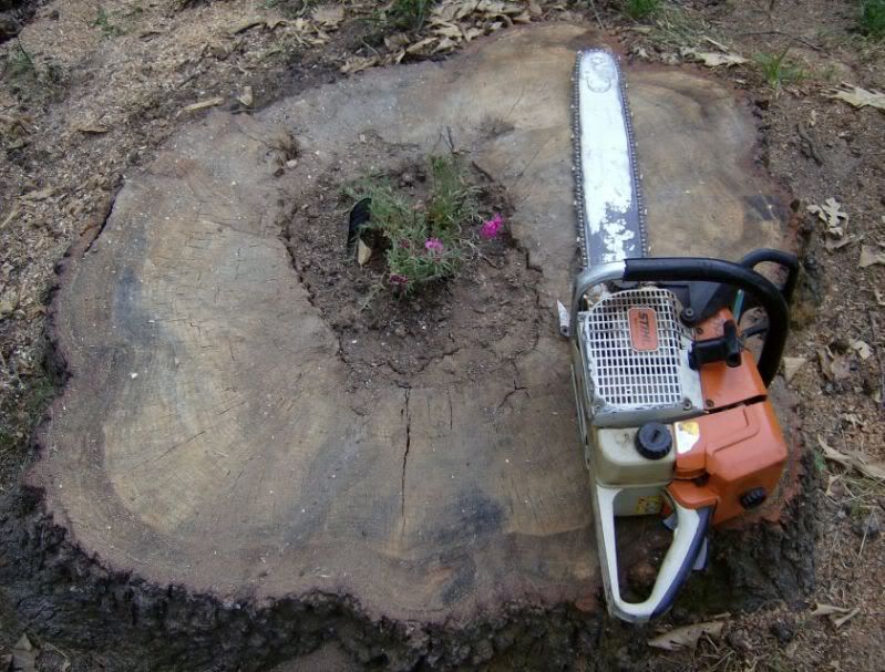

Nice work and whaaaaaaaaaaat a base, like to have seen how deep that base is do you have any refrence pics( hands in side, foot , something ) all in all good job.
Re: A few pics of yesterday\'s removal
Good work. It's hard to jump in a tree with a base like that.

Yeah, that would have been much easier but with the tree compromised as it was, wouldn't have been very prudent. I had to lower everything off of the left side to avoid any possible damage to the septic system, house and deck.
No way to get anything in there to the tree without risking damage to the septic system and leach field. Another year and we would have probably had to use a crane.
A few more pics for reference. Saw is an 044 with a 25" bar:
