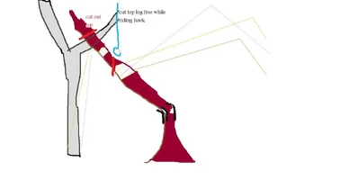

If you are worried that the crane can't pick enough weight, then maybe this could work. (See illustration)
I am aware that will be a lot of movement once the broken spar is free, and I don't know how strong the neighboring trees are either. However, if you think it could be done, with the shock absorbed by letting the butt run a little, then it may work.
But, my suggestion would be time intensive for the placement of the rigging...
