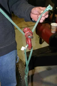

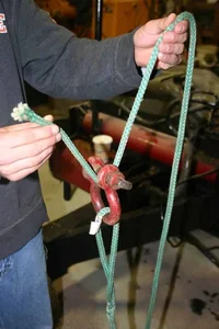

One shot of the sling rigged 10,000 lb stump..... shows the sling going through a shackle in such a way that IN THEORY could cause the shackle pin to loosen as the strap tightens, yeah, not likely, but I've heard its good practice to have the "dead "end of the shackle where it could be subject to rotation by the tightening sling, in other words the shackle pin in the fixed end of the sling.

I respect your reply and it is something I watch. As the sling tightens on the tree, I am right there watching it. I even give it a good extra turn with my scrench if I can after the crane has "loaded up." I agree that it could turn it loose, and I do try for the shackle to be in the right place, but sometimes it just doesn't work out that way. Thanks.
Re: 55\" Cucumber Magnolia
If this is the piece you are refering to all that would need to be done is feed the sling thru the shackle from the otherside. If it turned the pin then, it would only tighten it more.
http://www.treebuzz.com/forum/images/upload/142586-DSC00070.jpg
Here is the wrong way.The frayed end would hook to the crane
This is the correct way. If it were to turn the pin it would only tighten it.
