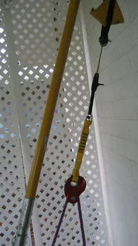

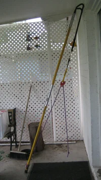

I recently started using mine to pull down the trigger on my bigshot. Got it with my REI divedend a few years back and have found alot of uses for it since.
Could you post a pic on that? Im having a little trouble visualizing how that would work/help?
