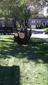

IMG_1280.webp Heres a pic I found, but doesn't really do it justice from the angle... Crazy Jimmy, the Isuzu should weigh around 13K lbs empty with no machinery... check out the 7th reply on this post for details.
Empty weight of the truck should be around 13,000 lbs without machinery and the Ditch Witch weighs ~ 1,800 lbs with grapple, stump grinder is 700 lbs and bucket is about 200 lbs, so with all equipment on it should weight around 16,000 lbs minus the mulch. The gross COMBINED weight rating on the truck tag is something crazy like 48,000 lbs (GVWR is 29,000 derated to 25,990), so it doesn't have a problem hauling the loads. I have used it as my sole chipper truck for the past 3 years and it has been great... I had to replace a turbo in it a year and a half ago (not uncommon for the mileage) and the transmission synchronizer was out on 3rd gear since I bought the truck so it has been replaced last year, but overall a very reliable truck. I would keep it if I wasn't a one crew operation, although my 16' dump trailer comes in handy for the bigger jobs. My new truck has a 25+ yard capacity so it hasn't been an issue.
The plan was to keep both Zahns for the really big jobs and for stump grinding, but with my Crawler 78 weighing in at a hefty 8,700 lbs, it will probably max out my 14,000 lb dump trailer with it and the lift in there, so I am indifferent about selling it... I could always use the money towards the loan I suppose. @ Crazy Jimmy - the truck was derated from the factory, it just has a 19,000 lb rear axle and 10,000 lb front axle... just like my Kenworth has a 22,000 lb rear axle and 12,000 lb front axle. In summary, it is rated for the bigger loads... just on paper it doesn't require a CDL if you keep the trailer under 10,000 lbs and DOT wont mess with you as long as you are tagged at a high enough weight (never been a problem here anyways, I've spoken with 2 DOT police officers about this).
[QUOTE="SRT4ME, No duals, but is 35.5" wide so perfect for gated yards... too bad Ditch Witch no longer sells them, they are as good as gold for our line of work![/QUOTE]
Did a bit of research. Only the smaller Zahn is discontinued. The Zahn 300 is still in production and should continue for many years.
Awesome... (y)Ditch Witch of Olathe told me that 2014 was the last year for them due to being a "niche" piece of equipment and not selling enough of them. Im glad you heard different because it truly is an awesome machine, niche or not. Gotta love it when you go to an actual dealer and they start making assumptions about a product they sell but dont know about just because they dont see them that often. :endesacuerdo:
