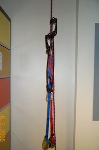

Here are a couple of pictures of the way I set up the RADS-Rope Ascending/Descending System.
Another option is to use a handled ascender as the upper. That is a good system for more up than down. Since we yo-yo, I'll put up with the 2:1 and have the Shunt tail along.

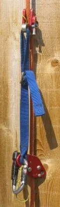

Here's the way that I setup my Pantin. If you look just below the P, red arrow, you'll see the little metal webbing lock that I put on to keep the stirrup from loosening. I changed the ankle clip, yellow arrow, and put on a metal spring loaded buckle like you'd find on a compression strap.

Tom,
For clarification, do you use the Pantin with the Rads also or just foolock?
You use the Rads only for longer climbs?
Why do you use the Shunt instead of a Microcender?--is there a difference? Are both springloaded?
How does the small cord release the Shunt to descend?
Do you tie-in the shunt to your saddle or only the Petzl ID?
Thanks.
Tom, thanks for taking the time to put together some pictures. Nice idea about the Revolver.
Hmmm, looks like Charlieb and I have a lot of questions /forum/images/graemlins/grin.gif
I assume the Shunt is above your hands and that you just push it up as you climb?
The 2:1 you refer to would only be for your legs, right?
Where did you get the buckles for your Pantin?
Do you think that setup would work well with a hitch (Knut) instead of a Gri-Gri?

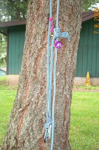

I’ve attached a picture of another SRT setup you posted on the ‘buzz. Which do you normally use?
I’m actually looking for two setups: one for actual work and one for exercise. The one you have pictured I think will be very well suited to a work environment. I also like the way the handled ascender is used (hands on top) in the URL you post posted.
The system I’m trying to put together for just plain exercise is a bit strange at present. I'll post a picture for everyone’s amusement and comments when I get it close to final.
The idea I had for a setup similar to Burnham’s to tend my hitch didn’t work well at all for SRT. I made one ascent and took it off. I’m not sure why. I’ll have to play with it some more.
