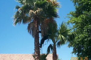

I'am not really crazy about palms , but when you can just jump from one palm to another without going up and down that can be fun... Here's my last job 25 palms ..
Later in SO-CAL climb safe

Are you using a cambium saver at the top??
Yes, that's a cambium saver that I have on that palm jump. I also have used a garden hose and I run my rope through it, that keeps it from getting torn up from the frons. Here is another pic on a diffrent set-up ..
Later in SO-CAL climb safe,,

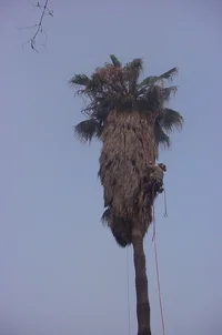

This one of the palms that can kill if not climb the right way. All the frons are all lose on this bad boy .
