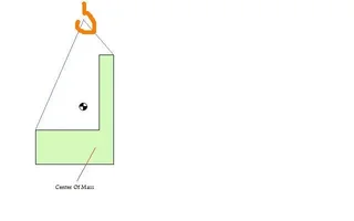

No the proper term is Center of Gravity. It is point of where the weight is evenly balanced and therefore rotates around.
Therefore, where we place the hook of the crane would become the center of mass for the load, right?
In the case of a rigid body, the position of its center of mass is fixed in relation to the object (but not necessarily in contact with it).
Rigid Body
According to the artical CofG and CofM are the same thing
"In the context of an entirely uniform gravitational field, the center of mass is often erroneously called the center of gravity "
The craning industry always calls it CofG

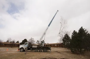

I make almost all my cuts,put the chainsaw down then lift the piece off the tree. It is much safer than the potential of a log coming at you while a saw is running. There is no reason this cant be done with a stick crane using a winch either. It is just easier to see the neccessary adjustments from the cutters position.
Heres a lift off a Populus canadensis, single steel sling and no movement after the cut. They can't all look like this with a limb in the right spot, but it is possible to balance a pick with a single choker and a little experience.
