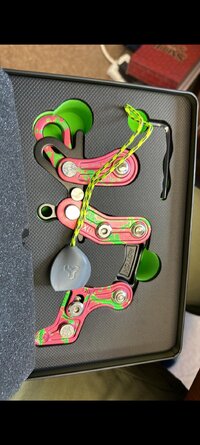

My friend just bought me this as a xmas prezzie. I have good friends in the arb world. Bee back on my runners for a few weeks, lets see what this got for Geezers.....a comp is a great time for a runner.View attachment 91516
I have been running my RR Pro quite a bit this last year and have come to really love it. So smooth, refined, and intuitive. The way this thing effortlessly flies up and down a rope is something to behold. I have run just about every mechanical I can think of, and for what I need out of a device the Pro is heads and tails above the rest.

How do you compare the pro to the singing tree runner? I've been on the singing tree and several other mechanicals for years but haven't tried the Pro.

Smoother up and down the rope. Better tending point. No dropped parts. Much better beak design. Feels great straight out of the box. Etc. A truly improved Rope Runner.
