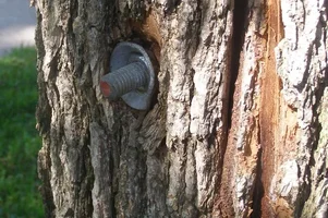

Here's a picture of a failed washer.
The corky bark should have been shaved down so that the washers could seat against solid wood. NEVER deep enough to expose the cambium though.
