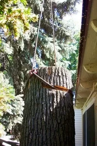

Ditto. The ferrule (bullet) can come out of the slide when not under load. They are not desgned for overhead lifting. If wire rope is being used, use an eye & eye, lock the gate on the crane hook and use a screw pin shackle on the other eye as the 'choke'. This way the choker doesn't have to be removed from the hook every time. After setting the 'choke' on the limb, make sure the pin of the shackle is not on the running end of the cable. The pin should be in the eye and the bow on the running end. This will prevent the pin from unthreading.
See attachment.
That looks scary close to the end to me Norm, but you do have large reliefs for the cable.... but still....
