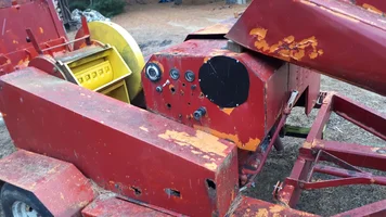

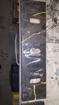

I am trying to identify a chipper I bought 2 years ago and need to replace the Anvil because the previous owners replaced the original one with a used one off of the wrong machine and I cant modify it anymore.
It is a mid 1970's 300Cuin Ford, drum chipper. It is a 16" chipper that will take up to an 8" tree.20191102_094253.webp
I am not sure the manufacturer yet. The nameplate is not readable but there is a number on the frame.
The Anvil should measure .750" x 6" x 16.125" with 3 slots.
It has a emergency safety drop down plate that covers the chute. 20191102_094253.webp

I was/am a machinist in previous years and can have it made although I am not 100% of the material and if they are hardened. I think it should be an A1/A2 or D2 tool steel material but not sure yet. It would just be nicer and possibly cheaper to buy it.

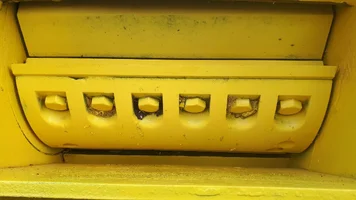

The Mitts and Merrell has a top hatch that opens, mine doesn't.

Bandit sells two different harnesses for some of their anvils. The softer one wears faster but may take a nail or bolt going through by accident a little better. The harder one wears better but....
I just assumed one was hot rolled steel and one was cold rolled by slightly rounded edge on softer one and look of metal surface. But...that's just me guessing.
The anvil on my Bandit needed replacing. I got a cheap piece of mild steel and drill/tapped the mounting holes. Then I laid a bead of hard face welding on both edges. It took a while to grind a square edge back on the hard face. The next time I’d bring it to a machine shop or sharpening shop. I used the first anvil edge for a long time and it barely wore
Not sure about the rigging between the infeed chute and the drum, but the counterweight wheel on the drum and the outfeed chute put me in mind of a Lindig Chipper. When I worked for a small city in the late '80s we had one that would easily take 8" stuff all because of that counterweight wheel. Also the outfeed chute was 2 piece and would slide out and turn to direct chips.

Thanks for all the advice and help. I was able to locate a VIN on the driver side of the frame and it is a Vermeer. It looks like a very early 1600A version as no anvils are matching up yet. I have sent Vermeer an email with VIN to see what they know.
Would anyone have any Vermeer 1600A manuals?
The VIN is 1VRC11150H1000289
