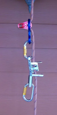

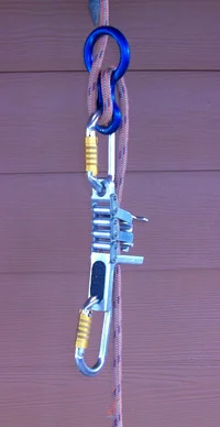

Here are some ideas I am trying in order to reduce excessive wear on the Uni in long, fast repel situations.

Dave. I like your suggestions of saving on wear for the Uniscender. In this first photo, could you just use a munter hitch on the biner and eliminate the figure 8?
It will depend on your weight and rope. You need smooth light friction, the munter for me is to much. Also I do not like the rope on rope friction in combination with speed.
Dave
the fate system and the unicender get married! The kong robot is a good tool for this app.

Yes, indeed, you get the credit for the idea on this.

A word of caution, when you add friction above the Unicender, experiment as it needs to be "light" friction. Too much and the Unicender will not grab consistently!

Thanks for the pictures Dave.
I was thinking of doing something like in your first picture with my petzl piranha but never got round to it.
I really enjoy the compactness of the unicender and climbing srt with very little gear but maybe I should start experimenting more again. Do you use the figure 8 only coming down at the end of a climb or do you use it more often than that.
The piranha should work fine and if I can figure out where I put mine, I will try it also.
Only use this on long fast descents to reduce wear that this activity causes. The attachments disrupt the upward movement simplicity while working the tree.
