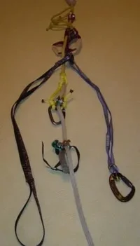

Can you guys provide photos? It sounds like these systems have a friction hitch plus an ascender plus another ascender. Why?

The VT is tied above the two handed ascender to add a backup and relieve the climber from having to tie it up in the tree. That may sound a bit stupid but every little bit counts!!!
If it's tied above the ascender then it's too long for me.
If it's tied above, dressed but isn't set then there might be a question of safety.
I keep all that gear above so I can dump it there in a second and leave it on the rope above and out of my way on a quick descent.
That's why I use my standard climbing hitch below the ascender.

Sounds like the Vt is backing up a backup. With the Kongs, the Croll, and the Vt you have three means of attachment. I just wondered what the thought process was behind all this.
Thanks kevin.
So the ascender is used for the ascent, the hitch is there so that you can descend quickly if needed, and the Croll is to back up the ascender (so if the ascender fails it doesn't crash down onto the hitch).
