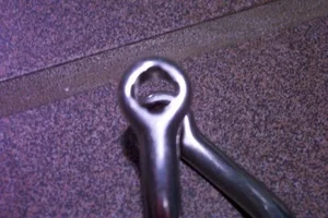

I have a twisted clevis that I used to use. This one is made by Wichard. The pin is a screw pin. I don't know if this makes it more secure, but when you are screwing in the pin in, as you get to that last one or two turns, you feel some reistance like there's a "bump" in the threads. There are two of these bumps and it takes a bit of extra force to get the pin to go past these two bumps. I like that idea. It makes me think that if it takes that much more force to close it, it should take a little more to open it, as well. Meaning that (hopefully) this thing will be a bit less likely to open "by itself."
Norm, is this what you meant by a "locking pin?"

Here is a close-up of the shackle. It has 4 notches 180 degrees apart. The pin has a flair at this end that fits into these notches to lock it securely and to prevent from unscrewing. This has been accepted at the ITCC.
