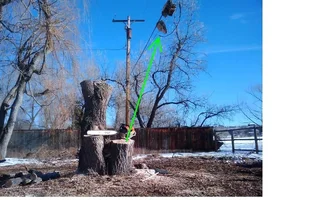

I did this job back in December. This was a Weeping Willow removal. It was allowed to grow out of control under the wires for many years. I suspected no less than 15 years the tree was neglected to be trimmed.
I was called to do the bid last Spring, but they finally called in the winter to get it done. Anyhow, the tree was all over the wires. If I had a better phone, with a camera on it at the time, I would have taken a photo of it in the Spring.
I ordered a "safety trim" to allow me the 10' of space I needed to finish the job. If I were thinking earlier that day, I would have taken the photo of what was remaining before I started. But, I wanted to get started and didn't think of it.
Instead, I have some photos of the after math. (I was finally at a point where I felt I could spare the time).
I'm sorry for the huge file size on the first one.
I tried to put in my other photo, which is smaller, but I couldn't.
Anyway, here is another to show location under the lines. The saw on the tree is a 088 with a 41" bar (for scale).

So, I started this thread because of the concerns for cutting these leaders while they were under extreme tension. And I'm not exaggerating either. They were tight. I kind of thought of the experience like a cross bow pulling back and when I needed to free up the thing it went! Granted, it didn't go that far or project anything, but it was a weird feel.
Anyone have any methods that can be safe for these measures?
As you can see from the photos, I basically cut as close as possible from the top side. I then cut as far into the wood as I felt safe to do so. I then followed through with my hand saw (on 2 of them). The third one got away from me and took shot off. Because I was on the opposite side of the tension, I didn't get hit. It shot away from me.
