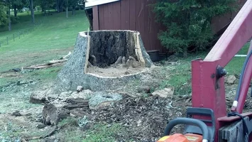

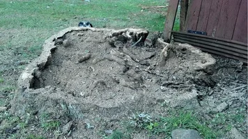

Here is a white oak that I cleaned up last summer. You would have never known the decay was so extensive unless you thumped on it with a hammer. Wondered how it stood for so long, and why it didnt fail at the base (instead of 30 ft).

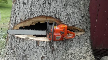

This is a 372xp with 24" bar for scale. I could have made the cut with my climber with out any problem.
